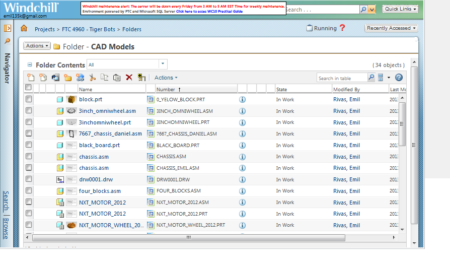

Hello to all,
Trying to check in and move the Tetrix KOP library from the workspace to the CAD Models folder...
that includes assemblies created by our team. One particular part hangs up the entire process...
Message states...
"Cannot check in place holder document CAD Part - set_screw_large.prt, A.1."
Even when deselecting "set_screw_large.prt" Creo/Windchill still tries to push it up and it fails the whole batch process. Even when trying to delete the component and it tells me that...

Fun times are blooming, I should have started this effort on Holloween :-). Here I am selecting the complement
files that are not in the CAD Files directory
Even though I purposely deselected these files preprocessor is telling me that I cannot upload these previously unchecked files and ignored the ones I selected!
stating+the+obvious+preprocessing+files+I+did+not+select+for+upload+and+bombing+out.png
Here its adding salt to the injury telling me I have not selected anything for check in.

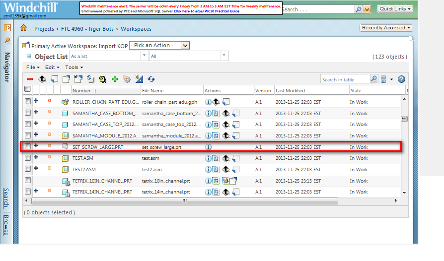

I up the ante, and say, "ok if you can't do partials I'll just wipe out all the files in the CAD folder and do a mass upload". Great idea on paper, but I get shot down again...
I understand conservative thinking, but tying me up and saying "NO" to purging and deleting to start clean is pretty painful.
It is CRAZY to think that all I am trying to do is to copy or mirror my Google Drive CAD folder into Windchill and it is giving me the third degree all over the place. This process should be seamless! BTW, that rogue part was not a part of the original file list that I was uploading to the workspace! Windchill just pulled it of somewhere while preprocessing.
It must have fallen out (in the virtual sense) of one of the assemblies when trying to upload them to the workspace! This is crazy reality :-). Notice no set screw in original Google Drive folder...
No set screw while importing to Windchill
Magical screw appears out of thin air "SET_SCREW_LARGE.PRT"
Why should I have to know the structures and dependencies of all the assemblies and parts in order for me to upload them to Windchill???? Why should screws fall out of assemblies while uploading!

You noticed correctly that the set screw was not one of the original files. That is why the error exists. Windchill looks through each file to determine what is required to build it. There must be matching files - either directly or by being part of a family table that is within a file. Some assembly or drawing requires the set screw, but there is no matching file.
Creating a part file with that name and saving it in the Google drive before trying to import it would fill the gap for Windchill. When the referencing item is opened there would still be a placement or other reference error, but the existance of the part would be accounted for.

This error is on PTC. I just tried importing the Textrix KOP and have 7 ghost objects that need to be fixed. I will try to get this done ASAP and post the update on the Community until we can have it uploaded on the KOP site next week. Sorry about the mix up. We should have validated this before releasing the KOP.

I have updated all the offending assembly files in the Tetrix KOP and added them to this document. It also explains a little bit about ghost objects in Windchill and how to update your local KOP files.
We should have the master downloads on the CDS site updated by Monday, after Thanksgiving.
To make things easier for everyone else, I have enabled the option Josh mentioned as the default action for everyone since it is a viable solution. I'll also try to cover this in next week's Robotalk session on Windchill CAD Data Management.
