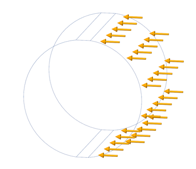

I`m designing the peristaltic pump for my project. I want to know how much normal force would be exerted on the roller when the roller squeezes the tube.
To find the force value, i tried simulation and selected the surface of the tube, then Creo just select the all the surfaces of the tube. Could you tell me how to select the half of the cylinder or sphere surface?

You have to split it using either a surface region or volume region.
For a surface region it is best if the sketch plane is normal to the cylinder axis.
Then draw one line splitting in half, accept the sketch and then pick the cylindrical faces to split.

Thanks for your help. Unfortunately my Creo license is for students, so, i can`t use that function. I will try it at my university CAD class Thanks
for students att.
Well that is not so fun.  I have not used the student version since Creo1 when it had all advanced simulation features available.
Since you cannot do a surface region, maybe just add small flats to your cylinder like the image.Add a small flatAdd a small flat
Another solution is a non-uniform load distribution, but maybe that is also not available in your version.
If you are able to do as this next image, and you do not want to use the flats, then let me know and I will demonstrate how to get what you want with a function for the spatial variation.
Non Uniform load distributionNon Uniform load distribution

To clarify, there is a surface copy, on the cylinder that can be trimmed how you like.  Due to the bonded interface the load on the surface transfers to the solid.
Region by coincident surfaceRegion by coincident surface
