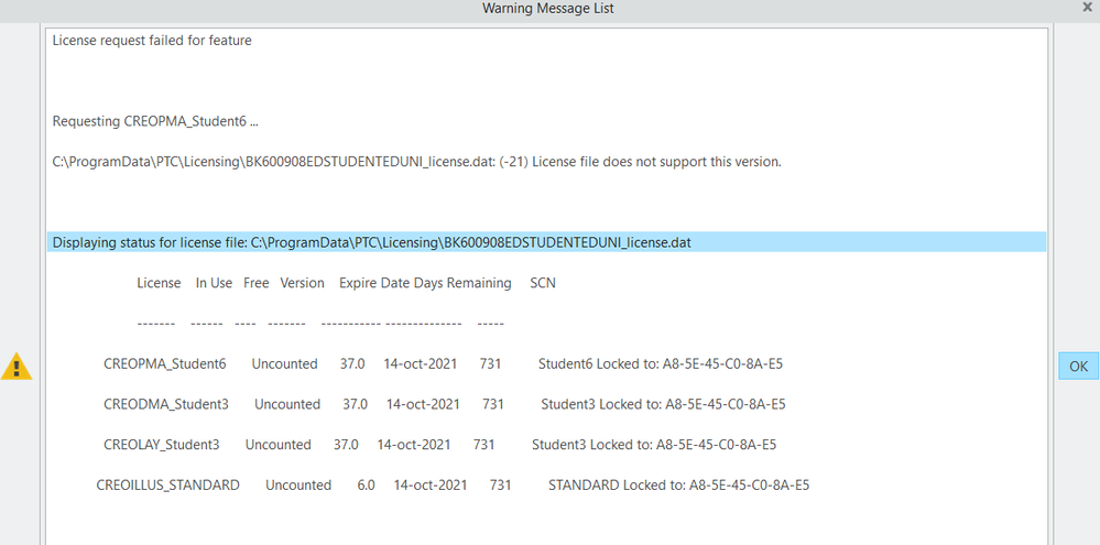

I have a similar problem. He typed everything correctly, there is even a success with logging in, but the release of the program pops up with a license error 😞 will you help me?obraz_2020-10-13_213151.png

your license file contains Creo 6.0 license. It cannot be used to run Creo 7.0.
Please read following documents slowly and carefully:
https://apps.ptc.com/schools/references/install_creo7_schools_standard.pdf
https://apps.ptc.com/schools/references/install_creo7_unistudent_standard.pdf
Martin Hanák
