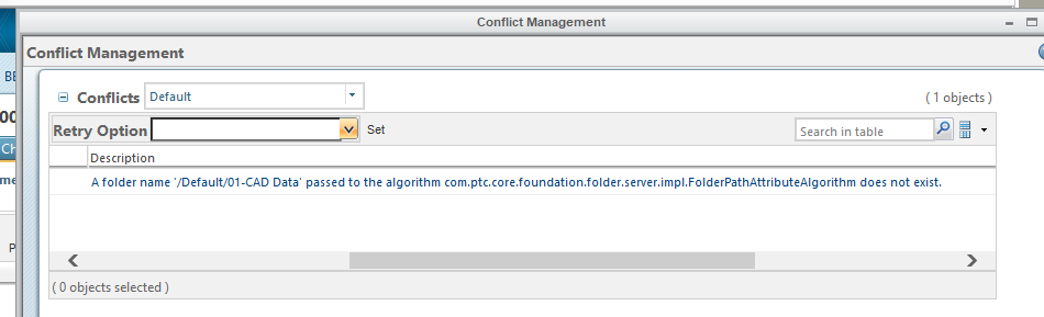

Does know what this error message means? I cannot upload a Creo part nor it's associated Windchill part.
I am getting check in error..."Cannot create a reflexive Usage/Reference Link. The following object is trying to make a link to itself. Any clues?
