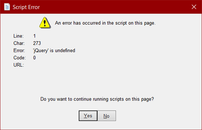

So, after getting a new SSD, I had to get creo again. At first, I had creo 3.0 and ran no problems on my older HDD, now that I have an SSD, I decided to get the latest 6.0 Creo. Install went well however, it says my JRE is out- of date. I do not know which to download and how to get creo to use it.
Also, each time I open it, script error windows appear. a couple of them are, "object expected", "JQuery is undefined", and "0".
Also, when starting up, it takes longer than I think it should startup. I know this laptop is more than capable of running this software, because it ran 3.0 flawlessly and anything else I throw at it. its a 64-bit windows 10 machine.
once creo is running, everything is running just fine.

I fixed everything except the slight delay in start up. I just disabled the browser window in the config settings.
All is good now. I can deal with the start up easily.
I suggest to set following config.pro options for Creo 6.0
windows_browser_type chromium_browser
web_browser_homepage about:blank
enable_3dmodelspace_browser_tab no
enable_partcommunity_tab no
enable_resource_browser_tab no
