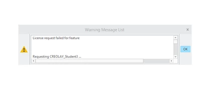

Warning Message when I open Creo.
hello, when i start my creo it displays a warning message list...
1 ACCEPTED SOLUTION
Explanation of your problem: You installed Creo 4.0 and PTC gave you Creo 3.0 licenses. Unfortunately this is current status of "things". PTC did not update their license generator, therefore you cannot get Creo 4.0 licenses.
"Solution": Install Creo 3.0.

please enlarge Warning window to show the whole text -OR- upload std.out file containing text.

this is what i get..
MH
Martin Hanák
I downloaded 3.0 and yet the same warning message. Any suggestion?
please attach screenshot showing error message.
