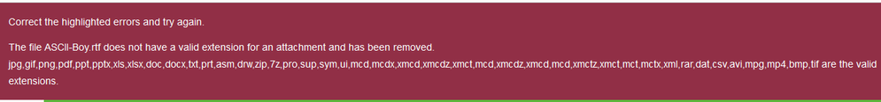

Let me first say that @Tmetcalf is aware of the problem and working on it.
I am just posting here as I have investigated a little bit more and I am curious if all of you have those problem, as at least on user had not.
There seems to be a list which tells Lithium which extensions should be allowed for attachments. RTF is not allowed (it should be added to the list) and that's the error message you get when trying to post a file which is not allowed:P1.png
As you can read, Mathcad files with extensions mcd, xmcd, xmcdz, mcdx should be allowed. But when I try to attach Mathcad files, I get a different error message and still am not allowed to do:P2.pngHere it looks like Lithium would be happy to accept an mcd file but it looked into the file and came to the conclusion that its not really a mcd file. Needless to say that all files I was trying to attach were valid Mathcad files. I am not sure how exactly Lithium will decide if a file is a true mcd file or not, but there seems to be a database and/or algorithm which is used for this check and which has to be updated for files of PTC products.
If that's true, nobody should be able to post mcd files - right?
What really puzzles me is that at least one user succeeded in posting a mcd file without manually zipping it first - no clue whats going on here. Its in this thread (its a pity we can't link to individual posts in a thread)  https://community.ptc.com/t5/PTC-Mathcad-Questions/MathCad-11-how-to-make-the-result-shown-in-line-with-the/m-p/476124#M172199
As far as I found out we can directly post    zip, pdf, mp4, avi, xls, gif   files (and possibly a few others like doc, jpg, etc. as well - haven't  tried).
Has anybody else (other than @anthonyQueen)  succeeded in posting a Mathcad file directly without zipping it first?
