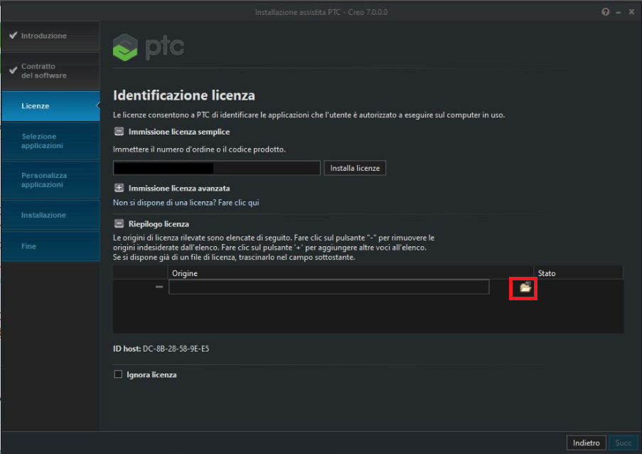

if you have access to old HDD then you can find there license file valid for your computer. It is located in C:\ProgramData\PTC\Licensing directory.
You can copy license file to SDD to directory of your choice and use browse button in installer window to select it.
Note: Entering of Product code is not necessary.

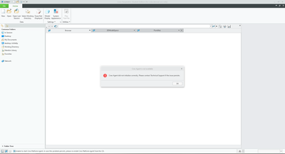

I successfully found and activated the license and now I have problem with Creo Agent (Creo Agent did not initialize correctly. Please contact technical support if the issue persists). I tried with creosvcs_64.exe and the issue and pop-up note remains even if I turn off and on the computer. It's working (not like before - the programme closed automatically), but I am still worried about the notification I am getting.

creosvcs_64.exe installs PTC Creo Platform Agent item.
Student version of Creo requires PTC Diagnostic Tools item, too. Use qualityagent_64.msi installer to install it.

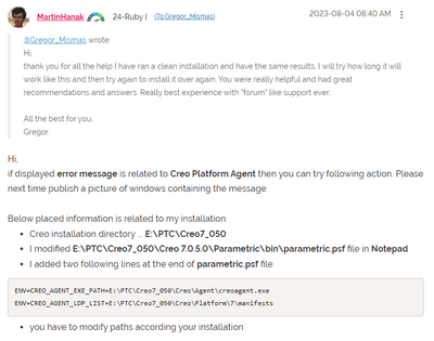

if displayed error message is related to Creo Platform Agent then you can try following action. Please next time publish a picture of windows containing the message.
Below placed information is related to my installation.
  • Creo installation directory ... E:\PTC\Creo7_050
  • I modified E:\PTC\Creo7_050\Creo 7.0.5.0\Parametric\bin\parametric.psf file in Notepad
  • I added two following lines at the end of parametric.psf file
ENV=CREO_AGENT_EXE_PATH=E:\PTC\Creo7_050\Creo\Agent\creoagent.exe
ENV=CREO_AGENT_LDP_LIST=E:\PTC\Creo7_050\Creo\Platform\7\manifests
  • you have to modify paths according your installation
