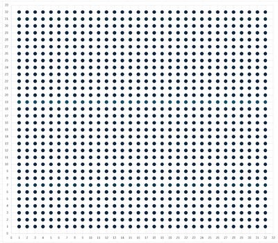

I want to make a bubble chart by by defining
i = 1 to 32
j = 1 to 32
so that 32 x 32 = 1024 points are generated
like as follows
(1,1), (1,2) , ... , (1,32)
(2,1), (2,2) , ... , (2,32)
(32,1), (32,2) , ... , (32,32)
the final output needed is

You don't say which software you want to use!??
In case you have Prime in mind, it would be best to post in the Mathcad section of this forum -> Mathcad - PTC Community
Here are two ways to achieve what you are asking for using Prime:
Prime 11 sheet attached
