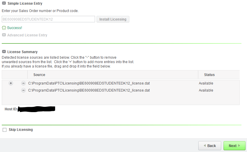

I'm getting this error. Looks like Creo is looking for the old license file???
before you start installation you have to read https://apps.ptc.com/schools/references/install_creo6_schools_standard.pdf document carefully.
If you had older Creo editions installed on your computer please go to C:\ProgramData\PTC\Licensing
and delete all the older licenses (you can also move them to another folder until the Creo 6.0 is installed). After the folder is empty you can proceed with the next step.
Also use BE600908EDSTUDENTEDK12 product code during installation.

Hi Martin,
I'm very sure I already did all that. No worries, let me try again.

Got it running! I renamed the previous installation directory (D:\PTC) to something else. Perhaps not all files were written over.
Thanks!
