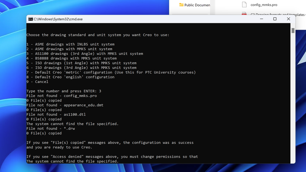

Hi All,
I am having the following error when trying to install the CREO drawing standards, and cannot find anything online to help me. I have loaded it as 'administrator' so permissions arent an issue and cannot find any info no matter the amount of digging I do to find it. I guess what I need to do is find these files manually and then enter them into the correct config files manually? I dont know where to start as there are hundreds of files.
Thanks in advance!
Same issue:
4 REPLIES 4
Same issue:
Thank you! I had to pretty much activate permissions all along the file chain instead of just inside Creo_standards
You're welcome.
just FYI ... you do not have to install Creo to default directory C:\Program Files\PTC. You can create your own installation directory, for example C:\PTC, set Full access to it and install Creo to C:\PTC\Creo11 (for example).
