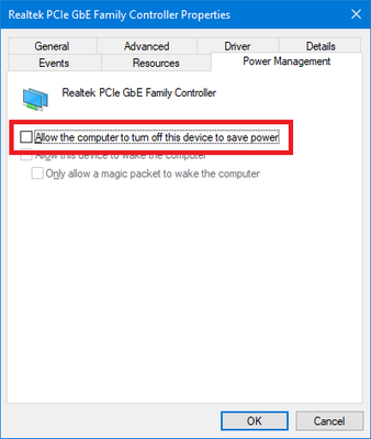

1.)
Start Device Manager and turn off power saving in Realtek USB GbE Family Controller properties. See picture.
Restart computer.

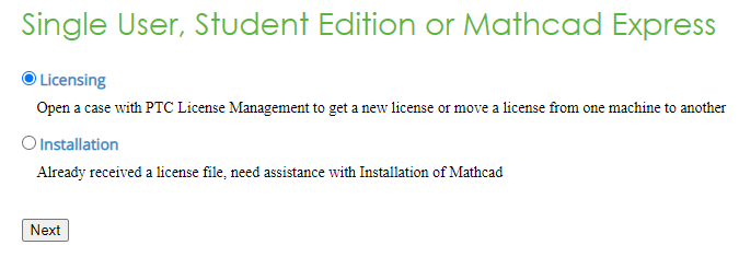

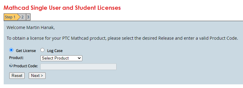

2.] Try procedure mentioned in https://www.ptc.com/en/support/article/CS68726 article (I guess it is invisible for you).
Go to http://support.ptc.com/support/mathcad_supportCenterSingleUser.htm page.
Select Licensing > Next
Firstly try Get License option and fill out the form ... I've never done it, so you'll have to figure it out for yourself.
What you need to get license file for Physical Address 00-E0-4C-68-03-30
If the first attempt fails try Log Case option ... again I've never done it, so you'll have to figure it out for yourself.
Explain that you need for Physical Address 00-E0-4C-68-03-30

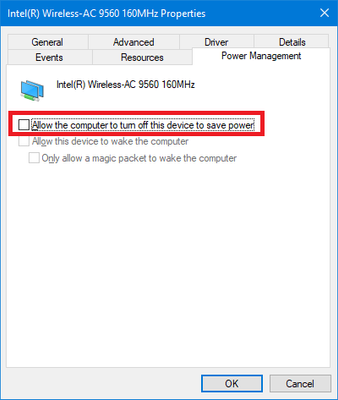

This means that Physical Address 18-CC-18-A5-23-8C is assigned to Intel(R) Wi-Fi 6 AX201 160MHz network card. It should be your laptop's internal wifi network card.
ip.txt generated on 2023-03-31 does not contain the above mentioned block of lines. This means that on 2023-03-31 wifi network card was disabled (i.e. Windows didn't know about it).
Conclusion
Intel(R) Wi-Fi 6 AX201 160MHz network card must always be enabled.
In Device Manager power saving in Intel(R) Wi-Fi 6 AX201 160MHz properties must always be turned off.

On my laptop, when I open Device Manager as  user with Administrator right, I can uncheck following option.
