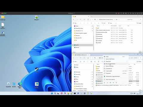

You can run Creo 10 (or earlyer version) on Mac M1 with Parallel Desktop 19.
Edit C:\Program Files\PTC\Creo 10.0.1.0\Parametric\bin\parametric.psf and add this line at the start:
ENV=PRO_MACHINE_TYPE=x86e_win64

1. If you installed Creo with defaults the parametric.psf will be created here: C:\Program Files\PTC\Creo 10.0.1.0\Parametric\bin\parametric.psf
2. Run Notepad as Administrator, the open this parametric.psf mentioned above. If the Notepad is not opened by Admin mode, you will not able to save parametric.psf after the modification!
3. Here is my modified PSF file header:
4. There is a bug with Creo 10.0.1.0: https://www.ptc.com/en/support/article/CS398358
So edit this file - C:\Program Files\PTC\Creo 10.0.1.0\Common Files\text\config.pro - with Notepad with Admin mode again and add
intelligent_fastener_enabled no
You can see here my config.pro:
Károly
