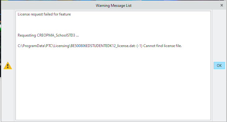

I was given the option to install Creo 6.0... After downloading the file and extracting it - i then ran the "Setup-school.exe" file.
After installing was finished i started the program and got the following pop up message.
Any help?

Product code BE500806EDSTUDENTEDK12 belongs to Creo 5.0, you cannot use it to run Creo 6.0.
According to https://apps.ptc.com/schools/references/install_creo6_schools_standard.pdf you have to use Product code BE600908EDSTUDENTEDK12 for Creo 6.0 installation.
Also ... please read carefully instructions included in install_creo6_schools_standard.pdf.

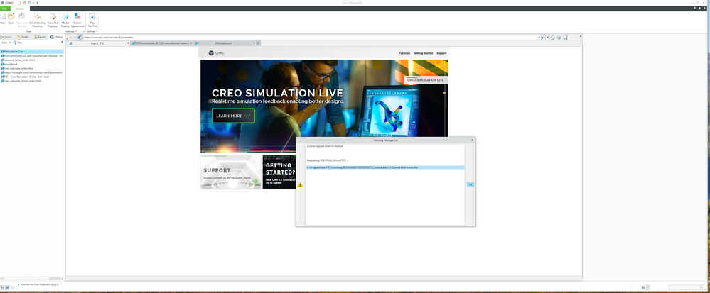

any more help??
please do following actions:
  • upload both license files
  • attach picture of "error message", only (I can't read information from "whole screen" picture)
  • publish INSTALL directory of Creo 6.0
I guess you need to modify parametric.psf file located in Creo 6.0.2.0\Parametric\bin sub-directory of Creo installation.

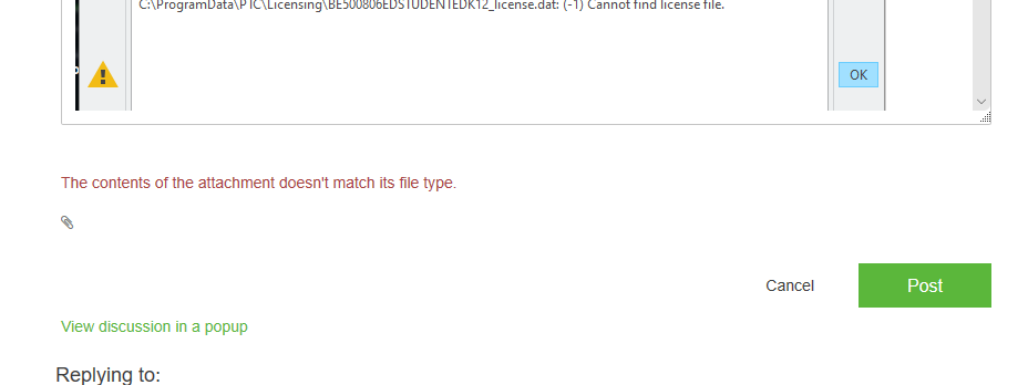

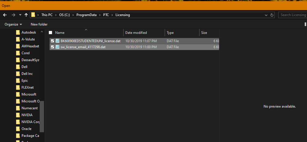

While I tried to upload the files the web site wouldn't accept them below is a screen shot
sw_license_email_4117298.dat file contains Creo Parametric 6.0 license named CREOPMA_Student6.
I am not sure what name is assigned to Creo Parametric 6.0 license in BK600908EDSTUDENTEDUNI_license.dat file.
Martin Hanák
Warning message List dialog box informs you that (during startup) Creo 6.0 is looking for C:\ProgramData\PTC\Licensing\BE500806EDSTUDENTEDK12_license.dat file ... this file does not exist.
Also Creo wants to use license named CREOPMA_SchoolsSTD3.
Suggestion: To avoid problems with uploading files, pack them into zip-file and upload zip-file
Martin Hanák

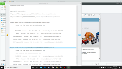

I am getting this error message. I have followed all the steps which are available/given in the PTC community
@Nikhil1 wrote:
Please help.
your license files contains Creo 5.0 licenses.
To install Creo 6.0 Student edition, please read:
https://apps.ptc.com/schools/references/install_creo6_unistudent_standard.pdf
K-12 students can use Product code BE600908EDSTUDENTEDK12
University students can use Product code BK600908EDSTUDENTEDUNI
Martin Hanák

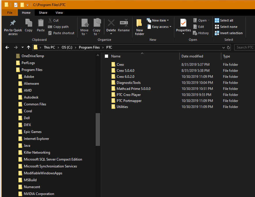

I think this is what you wanted to know as far as an install directory -
modify parametric.psf file - how do I do that again?
@Mrickeard wrote:
parametric.psf file is located in C:\Program Files\PTC\Creo 6.0.2.0\Parametric\bin directory.
Open it in Notepad and modify two rows:
Locate row starting with ENV=PTC_D_LICENSE_FILE-=
and modify it to get following content
ENV=PTC_D_LICENSE_FILE-=C:\ProgramData\PTC\Licensing\sw_license_email_4117298.dat
Locate row starting with ENV=CREOPMA_FEATURE_NAME=
ENV=CREOPMA_FEATURE_NAME=CREOPMA_Student6 ()
Save the file and test starting Creo 6.0.2.0
Martin Hanák

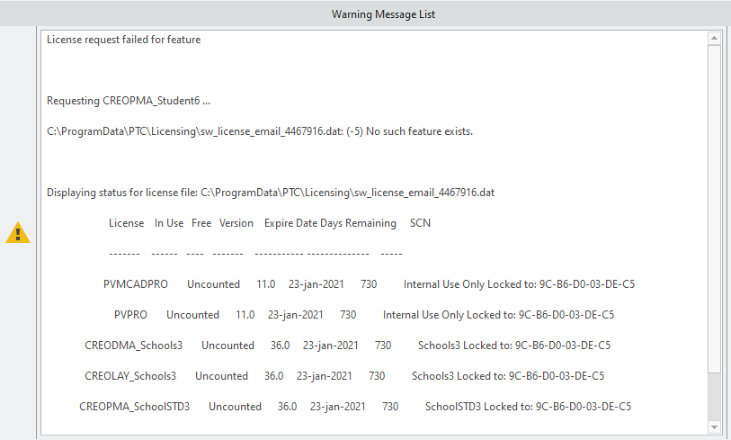

I tried your solution and still get an error message. I have listed the message below.
1.]
Please always describe the steps you have taken.
2.]
Your license file C:\ProgramData\PTC\Licensing\sw_license_email_4467916.dat contains Creo 5.0 license named CREOPMA_SchoolSTD3. You cannot use this license file with Creo 6.0.
3.]
Do you have other license file ?
