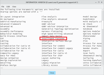

click File > Help > System Information > System Information and check the list of modules. To modify intelligent fastener models, you nedd Intelligent Fastener module license.
I guess that Student licence does not contain Intelligent Fastener module.
If you can run Creo at university lab using Academic license then you can check Intelligent Fastener module availability in it.
