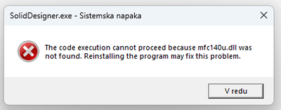

Hello! I did as you suggested. I reinstalled the program, but after starting it, this message appears. It did not ask for an account and password. What should I do?
