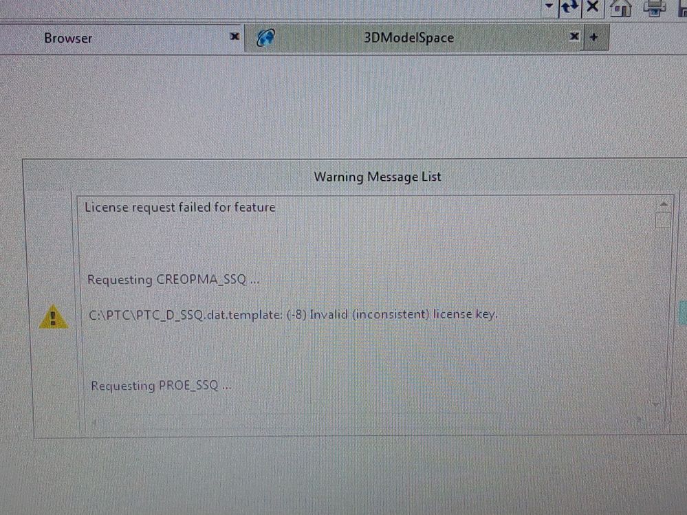

When downloading Creo 4.0 and booting up Creo Parametric, I could not use it as message popped up stating "License request failed for feature". This seems to be a recurring issue, but
not in Creo 4.0. Thanks for the help anyways. (By the way, this is the student edition).

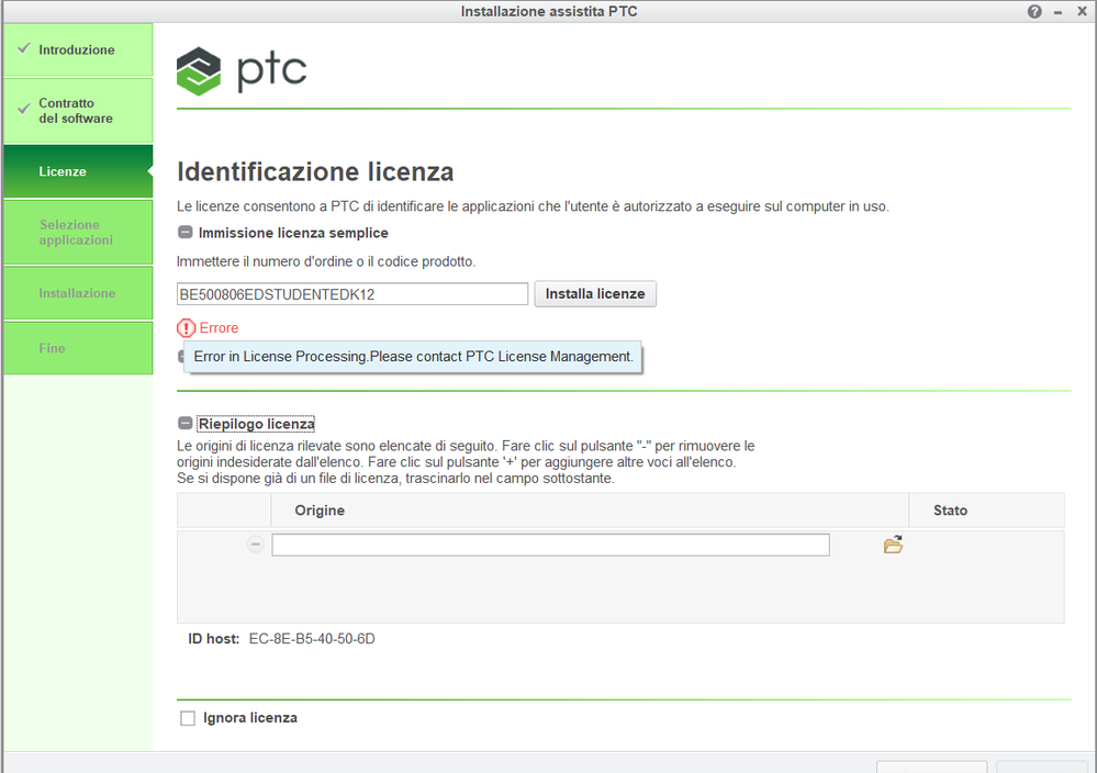

When I try to paste the code in the box shown by the guide I get the error that I mentioned before.
I can add pictures taken from the pc but they are in italian Language. Is it a problem?
No problem, upload a picture.
Also show the contents of C:\ProgramData\PTC\Licensing directory (upload a picture of Windows Explorer).

This is the errorThis is the error

If I try to search for C:\ProgramData\PTC\Licensing it says that it is impossible to find it
this is probably the root of your problem. Creo installer must be able to create C:\ProgramData\PTC\Licensing directory. I guess that you were not logged as admin user during installation.
Martin Hanák
dowloaded the file again making sure to be admin and still having the problem. The folder  C:\ProgramData\PTC\Licensing also is still missing
MartinHanak
(To:Brucco)
create C:\ProgramData\PTC\Licensing directory manually and set Full Access for Everyone in Licensing sub-directory.
The above is my last idea ... I really do not know what's wrong with your computer 😞
Martin Hanák
It did not work, but thanks for the effort.
