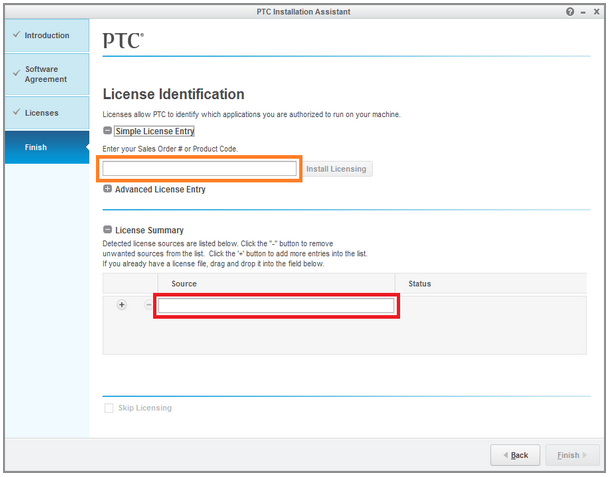

I tried installing creo, all went well, entered the student license BK410705EDSTUDENTUNICL and PTC math CAD worked by creo parametric said that the license doesnot allow this. I tried to uninstall and reinstall again after removing license files and now it says it cannot approve license 😞 I'm stuck, please help

1st installation put license file into C:\ProgramData\PTC\Licensing directory. Its name is BK410705EDSTUDENTUNICL_license.dat.
Please check whether the file exists. You can use it during Creo 4.0 installation. Put the file path to red field - see picture (I copied it from https://community.ptc.com/t5/PTC-Academic-Program-Questions/Can-a-lab-license-server-be-2008-R2-or-2012-R2/m-p/266239#M4748 dicussion).

Thanks! Actually all I did while reinstalling again was use the license used in the email, this fixed the issue 🙂 guess I made some mistakes in previous installation.
