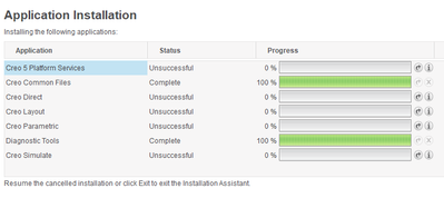

Can't find anything at all why it isn't installing. The only applications that install are Common Files and Diagnostic Tools. The licences are good fine, Anti-virus are off and its running with admin.

Tried this and didn't work. When I look at the more information icon it says "Prerequisite for Creo Parametric -- Creo 5 Platform Services -- is not satisfied. "

I just tried downloading Creo 5 and I am having the exact same issue. The provided "solution" doesn't solve anything. If you want a screenshot look up the thread, its the same problem.

Have you checked the media size? Have you tried changing the installation directory?
JBD
3-Newcomer
3-Newcomer
(To:Kishore_K)
I have got over 600GB spare and I changed its location to desktop
Kishore_K
(To:JBD)
Desktop is not recommended as the installation directory.....Try to create a folder in the local disk and then set it as the installation directory. Hope it works!
JBD
3-Newcomer
3-Newcomer
(To:Kishore_K)
Worked like a charm. Cheers mate, hope this helps everyone else with the same issue!
