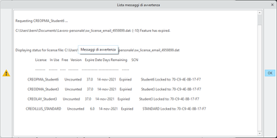

This is the screenshot:

try changing your password (as mentioned in https://community.ptc.com/t5/PTC-Education-Forum/License-renewal-issue-customer-not-verified/m-p/731070 discussion). Use ascii characters only in new password.
Also you can look at https://community.ptc.com/t5/PTC-Education-Forum/PTC-License-Renewal-Creo-4-0-quot-Customer-not-Verified-quot/m-p/588316
