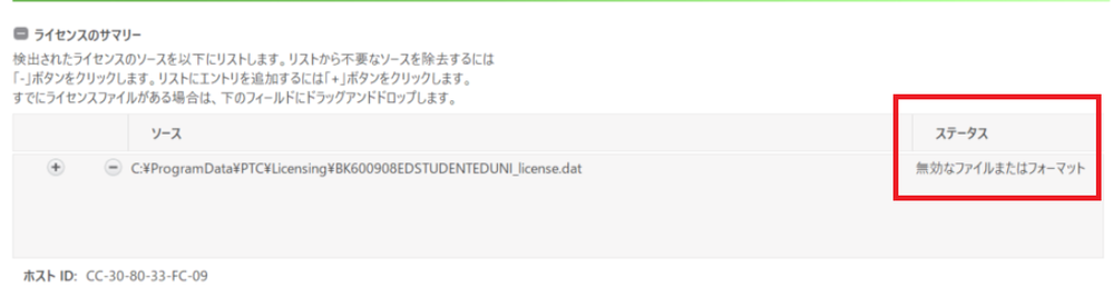

I want to use the student version of Creo 6.0.
I have entered the product code and successfully activated the license, but I cannot proceed.
I also created an academic account by following the PDF instructions.
Why can't activation be completed?
PDF:install_creo6_schools_standard.pdf
12 REPLIES 12
please translate text in red rectangle into English.
Martin Hanák
It says that it is an invalid file or format.
please upload license file mentioned in installer window.
Also open Command Prompt window, run ipconfig /all > ip.txt command and upload ip.txt file.
Martin Hanák
For some reason I can't upload.
So paste the contents of ip.txt.

There was no content in the license file.
from the fact that the license file is empty, I conclude that the installer is not able to detect the correct network card.
1.]
Remove all files from C:\ProgramData\PTC\Licensing directory (default location of license files).
2.]
Disable all network cards but one >>> Qualcomm Atheros QCA61x4A Wireless Network Adapter and repeat Creo installation.
3.]
If step 2 fails then disable Qualcomm Atheros QCA61x4A Wireless Network Adapter, enable Realtek PCIe GBE Family Controller (you have to connect via cable) and repeat Creo installation.

It doesn't work.
Ip.txt and license file after disabling the network card.
The license file is still empty.
please disable Microsoft Wi-Fi Direct Virtual Adapter #3, too.
Martin Hanák
I disabled the Microsoft Wi-Fi Direct Virtual Adapter # 3, but it didn't work.
my last tip...
3.]
Martin Hanák
Enabling Realtek PCIe GBE Family Controller did not work...
I am sorry I do not have any other advice.
Maybe non-english environment is causing the problem, try switching your Windows into English.
Martin Hanák
