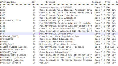

As I see on my licenses there is no generative design at Creo 7.0
Best regards
Mirko
