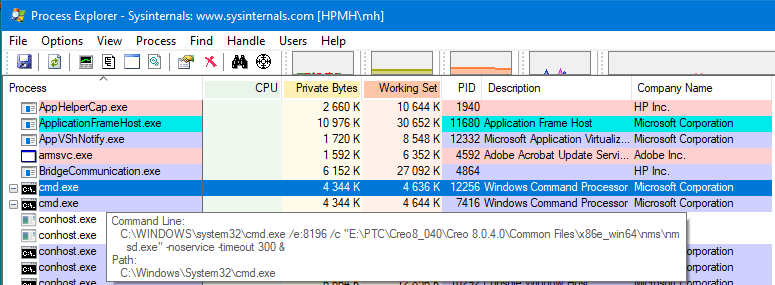

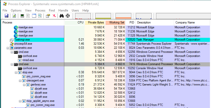

when I start Creo 8.0.4.0, two cmd.exe processes are started automatically. See following pictures of Process Explorer window. That's why you can't block cmd.exe (I would say).

Ok, thank you for confirming unfortunately that makes the software unusable for us as we can not allow students to run administrative tools such as command prompt. I imagine this is the case for most schools.
