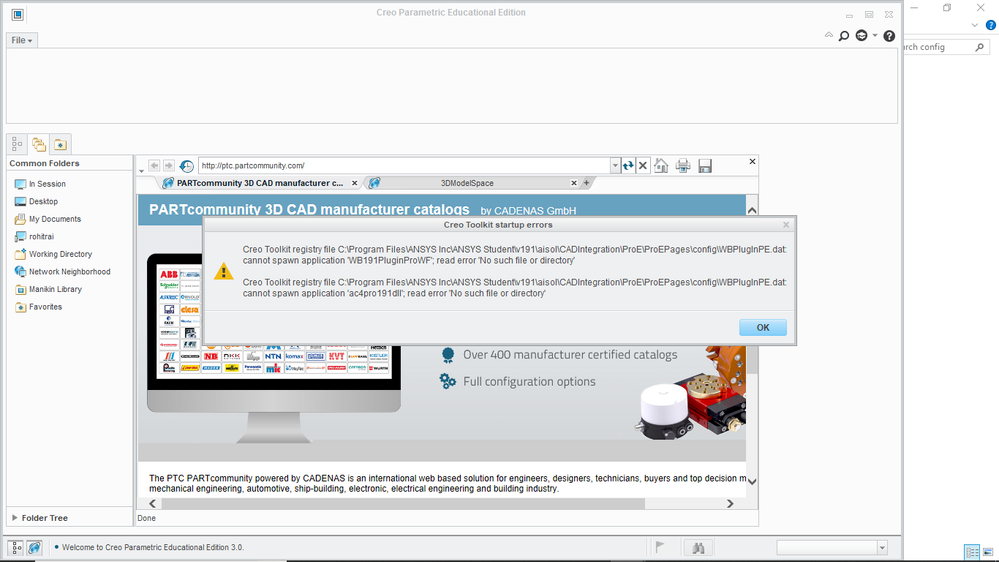

This is what appears when I try to setup ANSYS plugin in Creo Parametric 3.0.
Where is the problem? Is it with Creo, or with ANSYS? or my PC?
Please help me solve this

  • open WBPlugInPE.dat in Notepad
  • check path to files mentioned in the file ... all these files must exist

I have the same problem , Did you maybe get the solution ?
