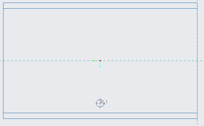

How can I get rid of the "A_1" name? The name is also shown when i set the dimensions in drawing. I have a drawing im supposed to replicate and the annotion name is not a part of it. Thanks

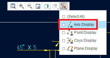

turn axis display off and repaint the drawing.
