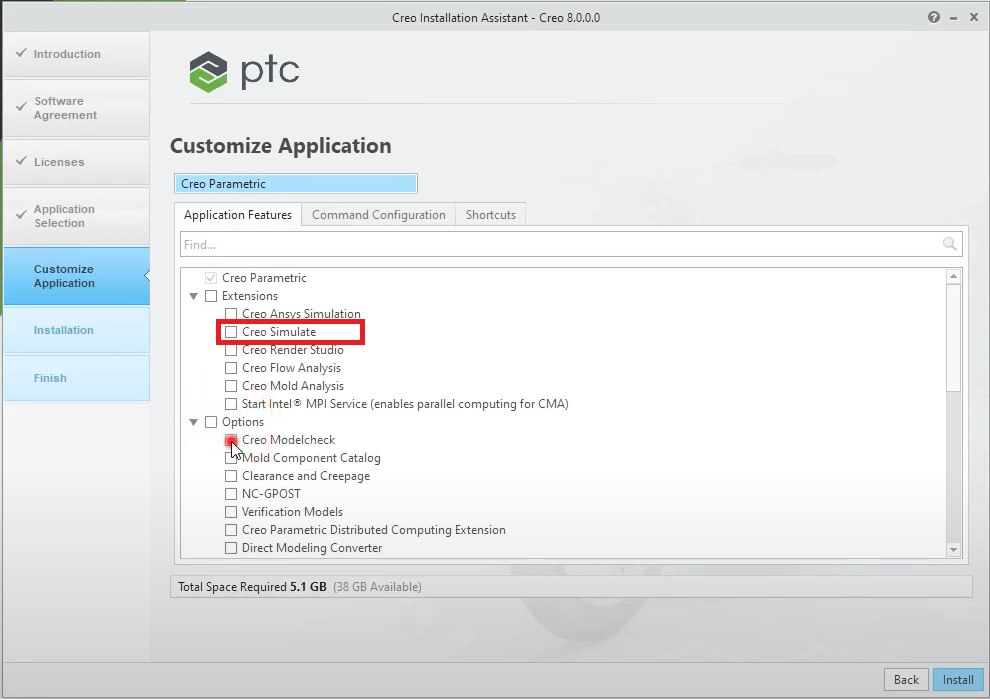

Hi
How do I get the Simulate lite application on my Creo Student download..
Only Creo parametrics is avalible. among the aplications when installing Creo 9.0.
https://www.ptc.com/en/products/education/free-software/creo-college-download/thank-you
Best regards
you have to select Creo Simulate item during installation.
