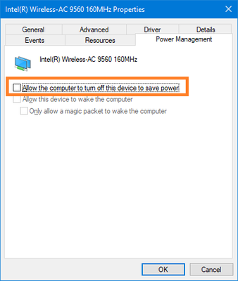

Hey,
So I have been using Creo for the past six months at home, and creo worked fine but when I decided to use creo at my school I kept getting a license error message (screenshot below) and two other errors saying AFX and IFX failed to load after this creo closes. Any idea how to fix this problem?
1.] The AFX+IFX error is the result of a missing license.
2.] I guess that you use Creo 9.0 ... therefore BK800908EDSTUDENTEDUNI license file cannot be used (it contains Creo 8.0 licence)
3.] I guess that BK900908EDSTUDENTEDUNI license file contains physical address assigned to WIFI network card and you do not use WIFI connection at school. In this case Creo cannot find WIFI network card and fails to start.
4.] To activate WIFI network card at school you can disable power saving property of network card ... see following picture as a hint.

Thanks alot this solution worked well!
