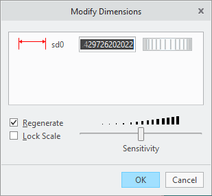

Try following workaround:
1.] select dimesion and use Modify command from minitoolbar
2.] edit value in dialog box
