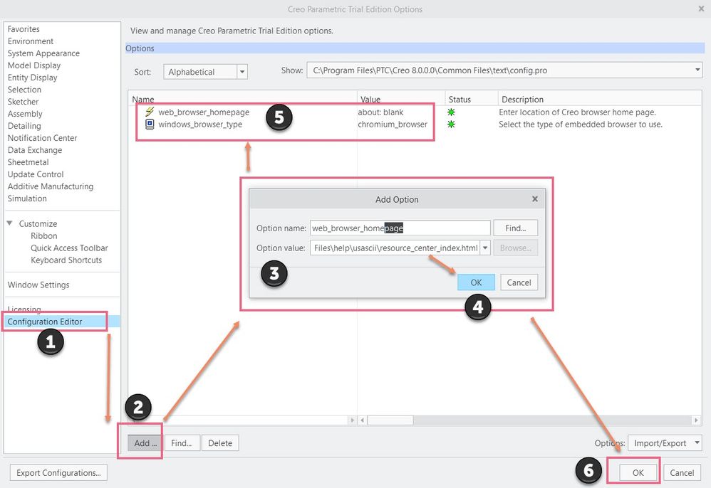

How to Set / Modify Creo Options, please follow below two options outlaying the process to make these changes:

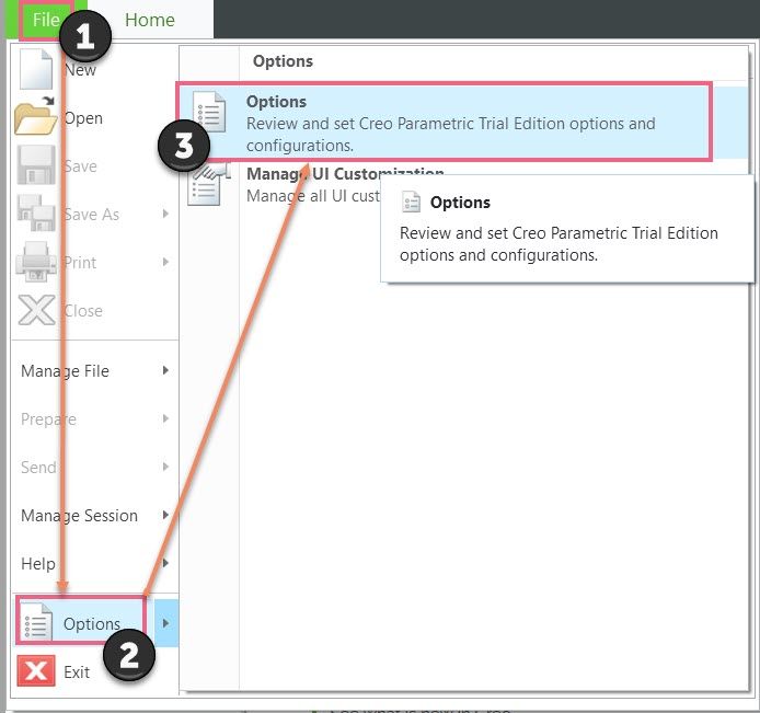

  • Option 1:- To set config option Launch Creo Parametric
    •  #File > #Options
  • #Options > #Configuration Editor
  • Add the config options as mentioned above (e.g. web_browser_homepage to about: blank)
  • Select #OK
  • When opted - Save to configuration file select > #YES
  • OK
  • Relaunch Creo Parametric trial version

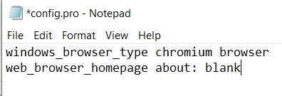

  • Option 2:-
    • Edit the config.pro file using WordPad or Notepad
    • By default, the location of config.pro file C:\Program Files\PTC\Creo 8.0.0.0\Common Files\text\config.pro
    • Add the mentioned config options in below format and then save the file
      • windows_browser_type         option value as       chromium_browser
      • web_browser_homepage           option  value as    about: blank
