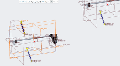

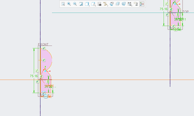

Hi, I have a graphic bug since a windows update. It consist a double view of the working screen one in overlay on the other. Anybody know how to solve this bug?

test:
Add following option into config.pro (using Notepad++) temporarily and test Creo behavior.
graphics  win32_gdi
graphics driver reinstallations
If Creo behaves well during test then problem is related to graphics drivers.
  • download graphics drivers from graphic card manufacturer website (or notebook manufacturer website)
  • uninstall current drivers
  • install drivers using downloaded package
