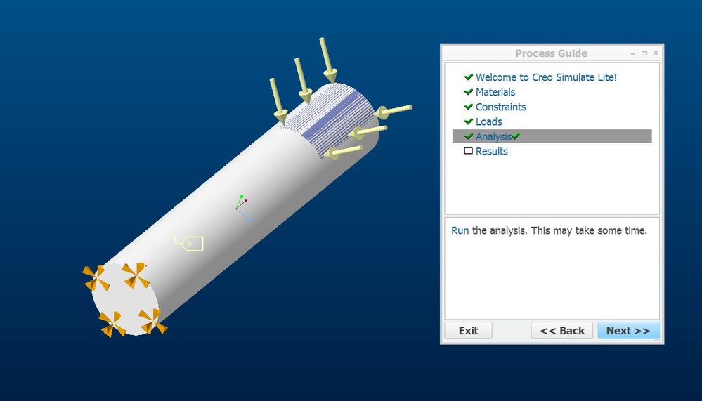

I`m designing the peristaltic pump for my project. I want to know how much normal force would be exerted on the roller when the roller squeezes the tube.
To find the force value, i tried simulation and selected the surface of the tube, then Creo just select the all the surfaces of the tube. Could you tell me how to select the half of the cylinder or sphere surface?

Since you cannot do a surface region, maybe just add small flats to your cylinder like the image.Add a small flatAdd a small flat
Another solution is a non-uniform load distribution, but maybe that is also not available in your version.
If you are able to do as this next image, and you do not want to use the flats, then let me know and I will demonstrate how to get what you want with a function for the spatial variation.
Non Uniform load distributionNon Uniform load distribution

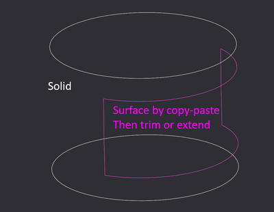

SURFACE REGION is not necessary
Did you use Engineering - Designate Area?
Thanks Skunks!
My default interface was set to be free and I did not realize this requirement although I remember you use this technique before.
To clarify, there is a surface copy, on the cylinder that can be trimmed how you like.  Due to the bonded interface the load on the surface transfers to the solid.
Region by coincident surfaceRegion by coincident surface

Sorry for the late reply. Thanks to your reply i did a proper simulation thank you very much 🙂 🙂 :)♡
