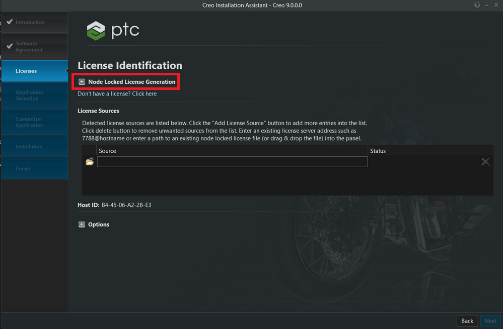

In that case, how do I get a Student License?
1.] download Creo 9.0, unzip downloaded package, run setup.exe and use Product Code.
K-12 students can use Product code BE900908EDSTUDENTEDK12
University students can use Product code BK900908EDSTUDENTEDUNI
During installation license file is saved into C:\ProgramData\PTC\Licensing directory.
The file should contain Creo Illustrate license
2.] download Creo Illustrate 8.0, unzip downloaded package, run setup.exe and use license file mentioned in step 1.
Download link ... https://support.ptc.com/appserver/auth/it/esd/academicFree.jsp
Martin Hanák
When I run the setup theres is no option for product code. It asks to input a license file.
please specify what setup did you use ... and attach a picture.
Martin Hanák
I am using Creo 9.0 as recommended above.
what about to click plus button.
Martin Hanák
... please ensure that C:\ProgramData\PTC\Licensing directory is empty.
Martin Hanák
Thanks Martin!
It worked.
