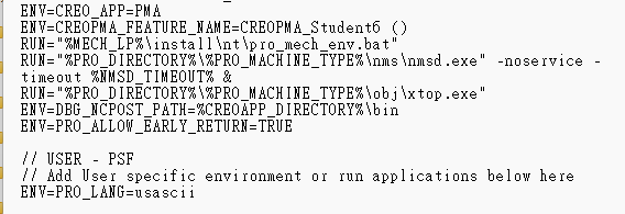

maybe my suggestion was wrong. In my psf files I use following line
ENV=PRO_LANG=usascii

Thank you for your reply. After trying once more and rebooting, it is still in the Chinese version. I'm not sure if it is related to my Windows being in the Chinese version.
"C:\Program Files\PTC\Creo 10.0.0.0\Parametric\bin\parametric.exe", This is the target of my Creo.
