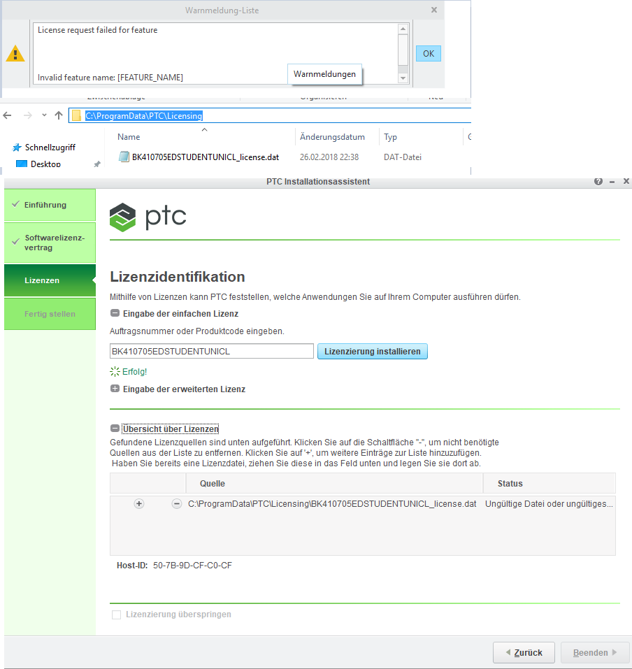

I just deleted the old License File because it was empty as you said. After that i tried to do the Licensing again by clicking setup.exe and enter the code BK410705EDSTUDENTUNICL and then it was successfully and i could click on finish. But when i start the same error Message comes again. I checked the license file and it was not empty.
Error Message:
License request failed for feature.
Invalid feature name: [FEATURE_NAME]

my suggestion is:
  • unistall all Creo 4.0 items
  • remove all files from C:\ProgramData\PTC\Licensing directory
  • run setup.exe and install Creo from scratch

Everything is working now. Thank you very much for your effort!
