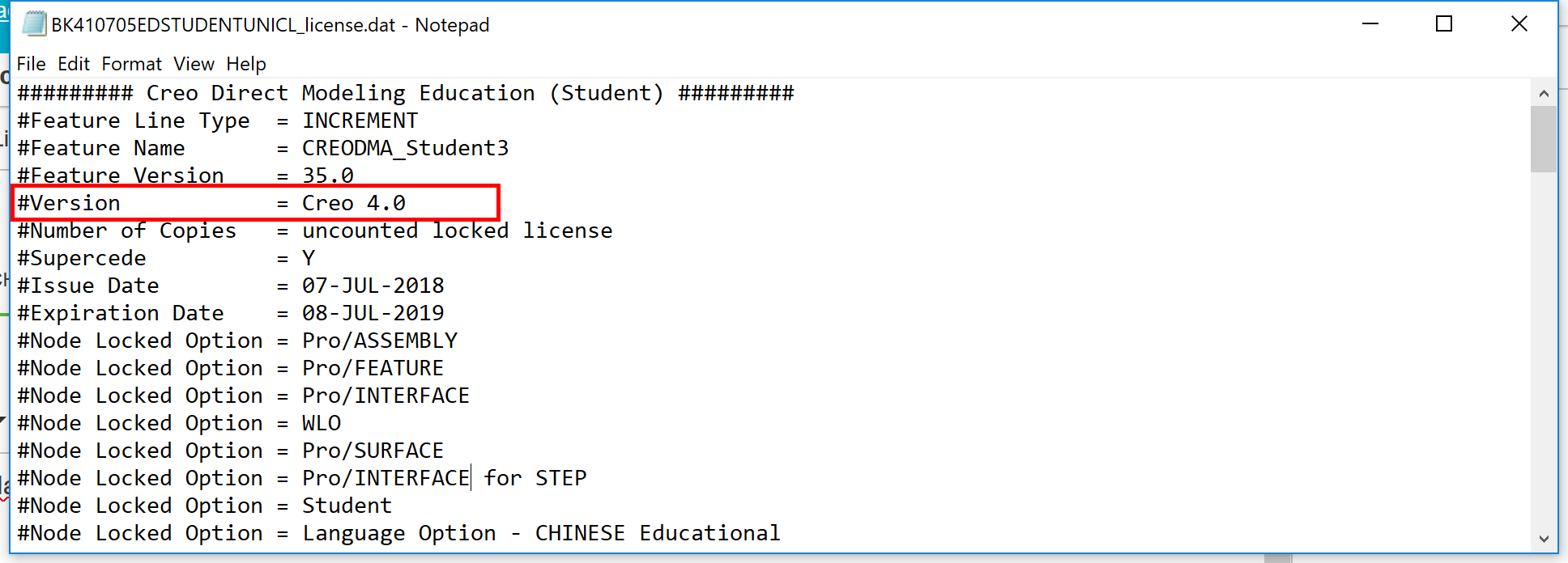

I opened the license file on C:\ProgramData\PTC\Licensing and saw, that this license was for Creo 2.0 ?!?!
The license file was created automatically during the installation process, and there was a success message.

Installed creo 4 and got a license file for Creo 3 !!! 🙂

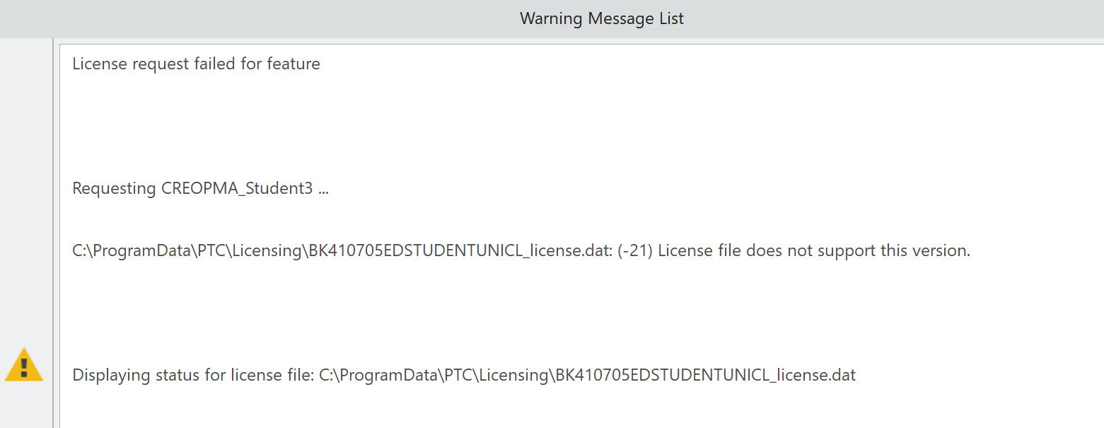

I'm having the same issue. trying to install Creo 5.0 Academic getting the below error using the Product code BK410705EDSTUDENTUNICL and BE410708EDSTUDENTEDK12 both. The file shows Creo 4.0 as version. screenshots below. Please help I'm trying this for last 2 days and getting very frustrated

Can we get an actual answer for this? I have this issue but with a purchased student premium 4.0 license... the installer keeps giving me Creo 5.0 and my license doesn't work for that; there seems to be nothing that I can do.
