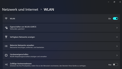

first of all, thank you for trying to help!
I changed to not randomizing th Mac-Address but I still have the same Issue with the License.
Everytime I use a different Wifi or no connection to the Internet, I have to reconfigure Creo and add a new License. I`m already running out of Licenses.

please read my answer in https://community.ptc.com/t5/PTC-Education-Forum/licence-unable/m-p/811770 discussion.
