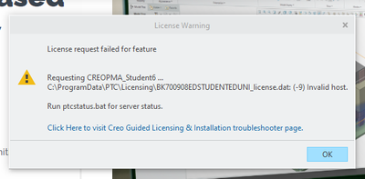

I am trying to get into Creo Parametric 7.0.8.0, but am getting the following errors - these three errors pop up and then the program automatically closes. Any thoughts on what needs to be done to fix this?

Similar issue before - "Licence request failed for feature, error (-9) Invalid host": https://community.ptc.com/t5/PTC-Education-Forum/Licence-request-failed-for-feature-error-9-Invalid-host/td-p/782501
license file is generated for network card physical address which is not available.

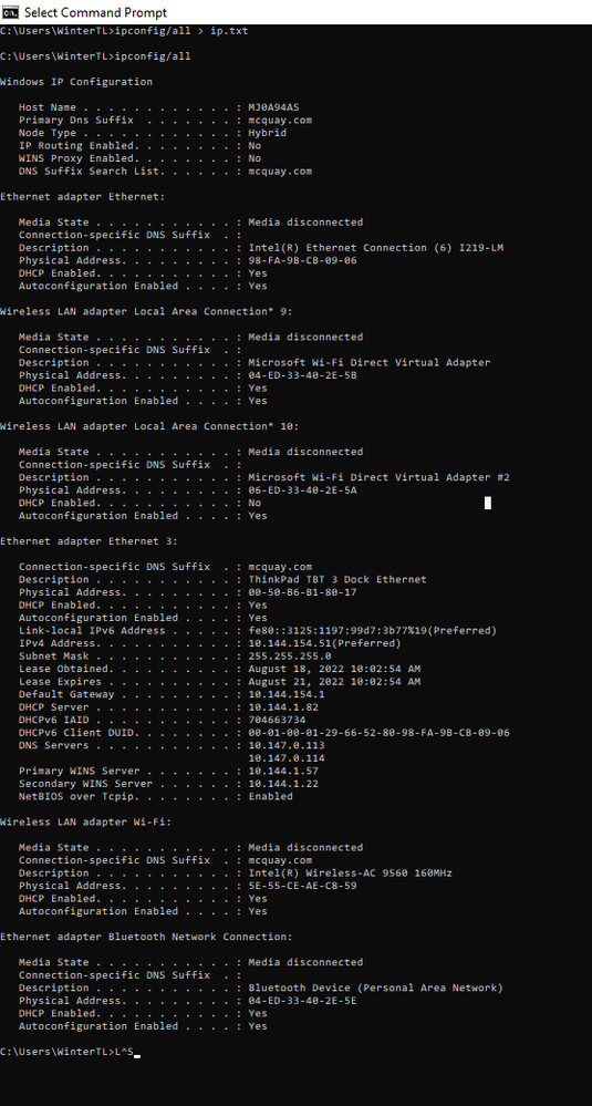

Please upload your license file and ip.txt file generated by command ipconfig /all > ip.txt in Command prompt window. I'll check these file and let you know.

in ipconfig /all output I found following physical addresses:
internal Ethernet ... 98-FA-9B-CB-09-06
Thinkpad TBT Ethernet 3 ... 00-50-B6-B1-B0-17
Wireless ... 5E-55-CE-AE-C8-59
One of these addresses must be present in license file.
I do not know what physical address is used in license file, because you did not upload this file. Please upload the file -OR- open it in Notepad and publish picture of file part which contains INCREMENT line.

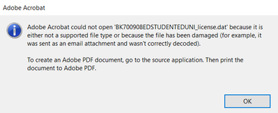

Good morning Martin - I am entirely new at this process.
Can you please explain how to get to the license file? I do not know how to access the file to show you the information that you need. Can you provide the steps to get to the license file?
I am not plugged into a docking station.
Many thanks!

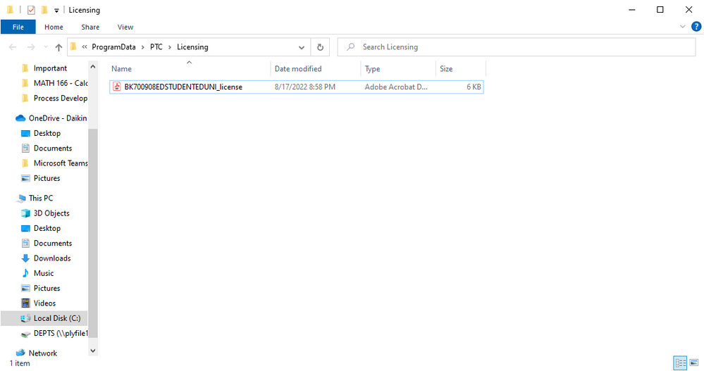

this is your license file ... C:\ProgramData\PTC\Licensing\BK700908EDSTUDENTEDUNI.dat
In below picture .dat extension is hidden.
Martin Hanák
How do I reveal the .dat?
try to find out yourself, you can ask google.
Martin Hanák

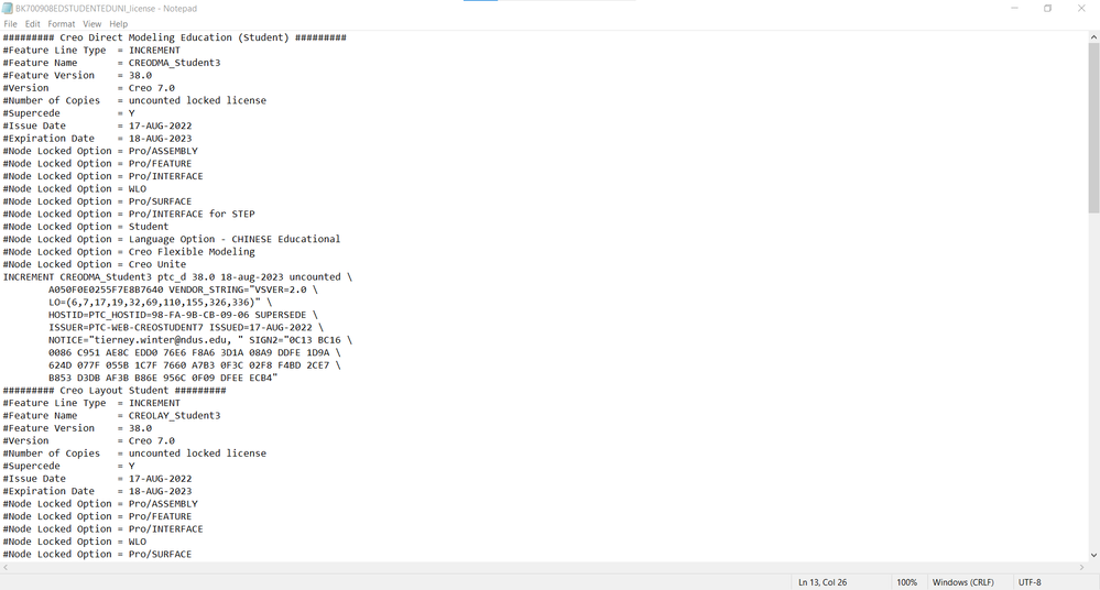

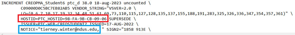

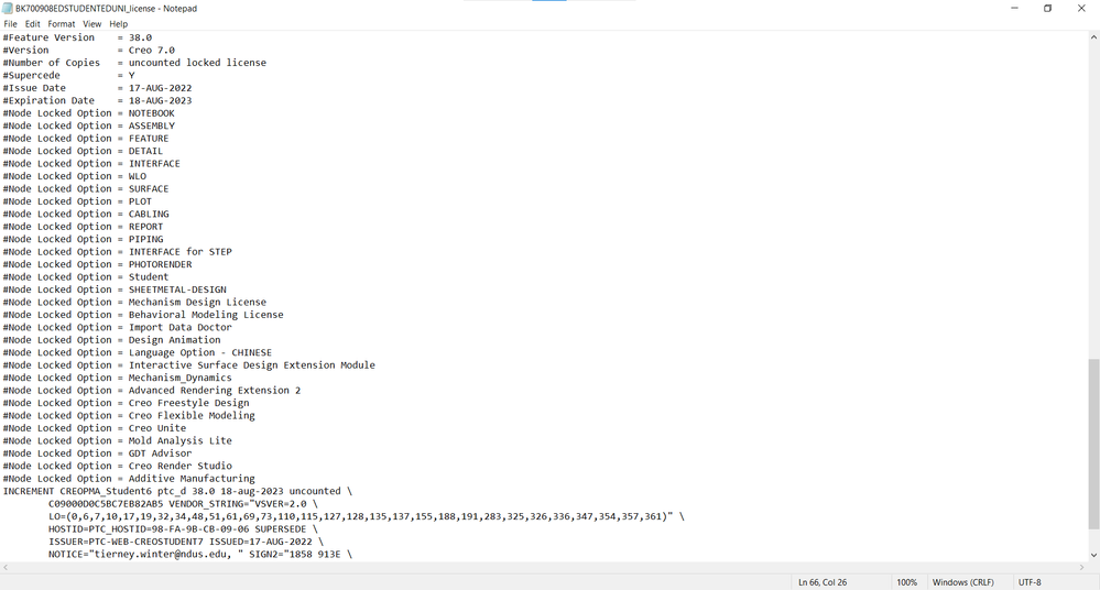

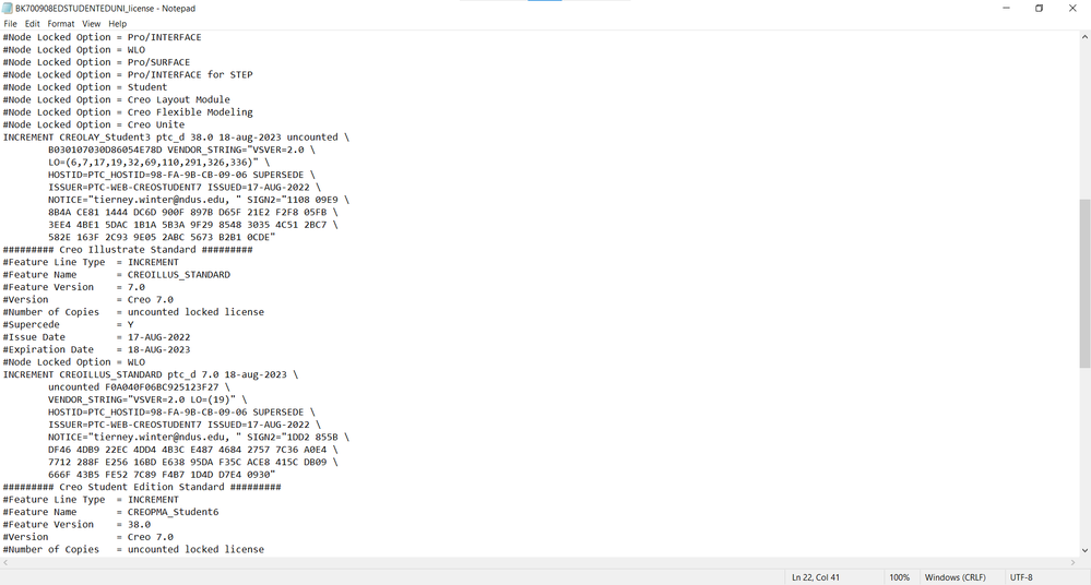

Martin - please see below:
Screenshot 2022-08-19 124739.pngScreenshot 2022-08-19 124725.pngScreenshot 2022-08-19 124710.png
your license file contains following block of lines:
License was generated on 17-aug-2022 for physical address 98-FA-9B-CB-09-06 and user identified as tierney.winter@ndus.edu.
So everything looks fine.

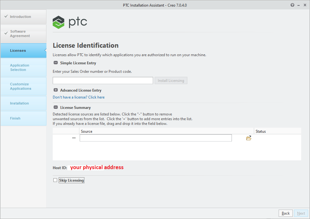

INFO:
When you start installer and click Next twice, you will see following window. In it physical address is displayed.

ipconfig /all output tells that network card with physical address 98-FA-9B-CB-09-06 is turned off (because no cable is plugged in it). Disable this windows feature - see uploaded video turn_on_network_card.mp4. Then restart computer and try launching Creo.
