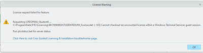

License request failed for feature
KF_12739663
2-Explorer
I have tried everything and nothing seems to work. I am using creo 7
This is all I get
2 REPLIES 2
1.] student license is the locked one
2.] locked license is not available via Windows Terminal Services (floating license is needed)
Use Teamviewer session to run Creo remotely on remote computer. Maybe Remote Desktop Connection will work, too.
