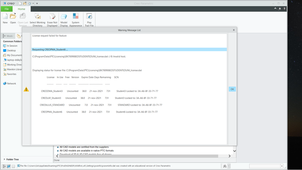

License request failed for future - student version 7.0

@PT_9721946 wrote:
i did attach the file
I can't find 3A-A6-8F-33-71-77 in ip.txt file. Therefore you cannot use your license file to launch Creo.
I am not sure whether PTC installer work well when your computer is connected to Internet via Remote NDIS based Internet Sharing Device (22-F6-4F-3C-12-86).
Suggestion: Connect to Internet via Realtek PCIe GBE Family Controller (8C-16-45-6B-B2-97) and disable all other network cards. Then uninstall Creo, clean C:\ProgramData\PTC\Licensing directory and install Creo.

license file mentioned on 1st picture contains license generated for network card with MAC address 3A-A6-8F-33-71-77.
Invalid host error message tells you that Creo did not found network card with MAC address 3A-A6-8F-33-71-77.
Suggestion:
  • open Command prompt window
  • run ipconfig /all > ip.txt command
  • upload ip.txt file
  • I will check contents of ip.txt file
Martin Hanák
Martin Hanák
Thanks for the solution
its working😀
