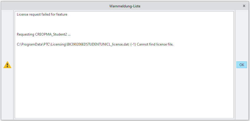

Its always the same problen and I dont know how to solve it.
I been trying it for a few weeks but it doesnt work up to now.
I also tryed it with creo 7.0.
1 REPLY 1
It seems that you are not installing the correct Creo version (as stated there you are installing Creo 2.0 and not 7.0).
Please follow this guide in order to install Creo 7.0 Student Standard Edition:
https://apps.ptc.com/schools/references/install_creo7_unistudent_standard.pdf
