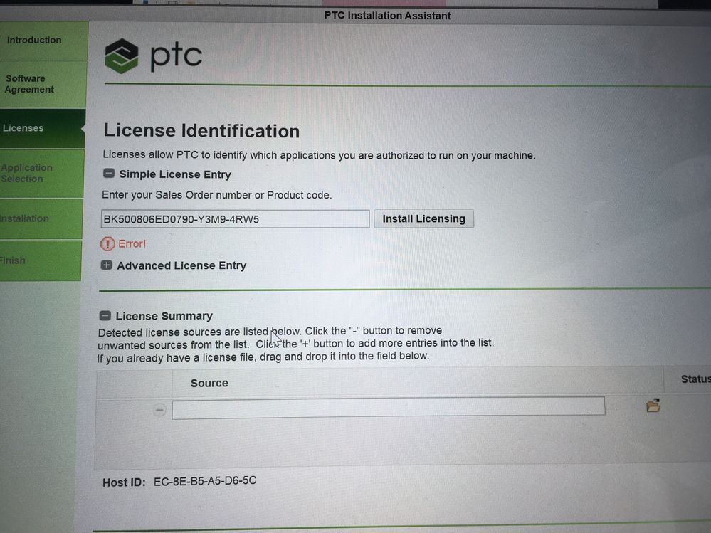

So frustrated with install of Creo 5.0 on Windows 10....nothing but non-specific error! messages 😞IMG_7054.JPG

check your email box ... maybe PTC sent you license file via email.
In case that you received email:
  •  save license file to disc
  • launch installation
  • do not enter Product code
  • enter path to license file to Source field
Sometimes installer has problems with network cards. Please open Command Prompt window, enter ipconfig /all > ip.txt command and upload ip.txt file. I will check its contents.
