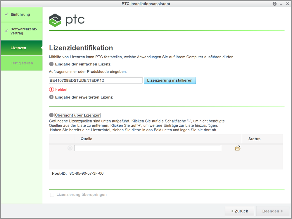

Hey,
i'm still having issues. please let me know how to proceed.
thanks
when I klick on the red "Fehler!" Icon it says: "Error in License Processing. Please contact PTC License Management"
I have exactly the same problem as in the pic. 😞
I need the programm! need to finish a project over christmas.
Please solve the problem as fast as somehow possible.

Your issue is that you have multiple licenses on the computer, or you licensed Creo 5.0 after installing it. In any case there are a few simple steps:
1. On your computer go to C:\ProgramData\PTC\Licensing and move to another folder all its content (you can delete the expired or older licenses if you no longer need them).
2. Run setup.exe and choose reconfigure existing software.
3. Drag the license you already have in the special area (under License summary).
4. Complete the process.
If for any reason this won't work, you will need to uninstall Creo 5.0 and take the same steps, but in step 2. select install new software.
Alex

I still have problems with the license...first i had the same failure like you. i reinstalled it and now its this error...
it looks like that in Creo installation directory there is no parametric.psf file. Please check it.
Also check the contents of C:\ProgramData\PTC\Licensing directory. Is there any licence file in it ?
