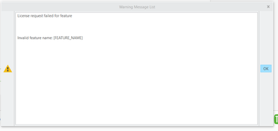

please do following:
  • launch Creo
  • enlarge message window to display complete message
  • make a screenshot of message window
  • upload picture of message window
Martin Hanák
@MartinHanak Please see attached and view individual posted issue Here
MartinHanak
(To:Gerbs)
this message means that you skipped licensing during installation.
Did you receive email containing copy of license file ? Please zip it and upload it.
Is there any file in C:\ProgramData\PTC\Licensing directory ? Please zip it and upload it.

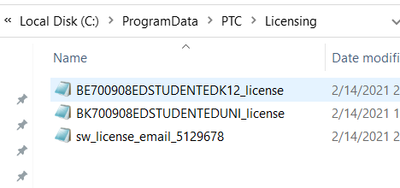

@MartinHanak There are three files in C:\ProgramData\PTC\Licensing, the two student licenses and the one that was emailed to me, imaged below. I would prefer to not upload the SW_License_email file as it has my personal information in it.
see https://community.ptc.com/t5/System-Administration/Error-License-request-failed-for-feature/m-p/389315 discussion.
License information is included in psf-file located in <Creo7_loadpoint>\Creo 7.0.x.0\Parametric\bin directory.
To create psf-file you can run reconfigure.exe located in the same directory.
The default file name is parametric.psf. This file contains following lines:
ENV=PTC_D_LICENSE_FILE-=PATH_TO_YOUR_LICENSE_FILE
You have to substitute PATH_TO_YOUR_LICENSE_FILE with real path.
ENV=CREOPMA_FEATURE_NAME=LICENSE_NAME ()
You have to substitute LICENSE_NAME with real name located on INCREMENT line inside the license file.

@MartinHanak I ran the reconfiguration following
and it now works. I did not have to substitute my license location.
Thank you for your help!
