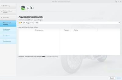

After calling the installation, I was able to generate the license with my received product code. However, in the next step, the application selection is empty and I could not proceed with the installation. I tried it again today and now the error message "You have reached the maximum number of license requests available for your product type" comes up when creating the license.

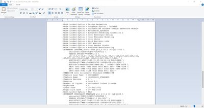

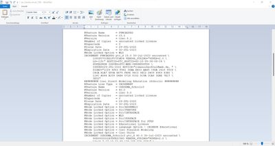

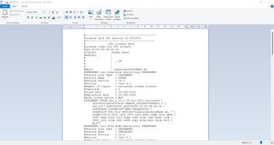

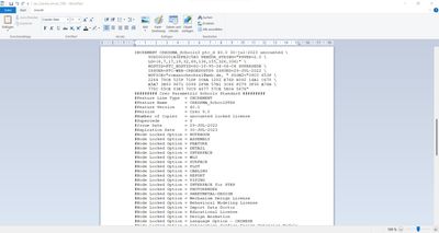

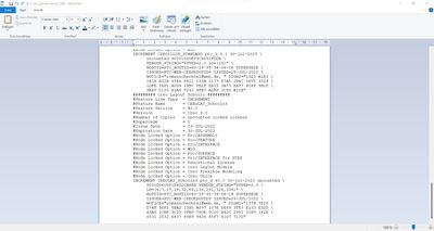

Make a backup copy of license file located in C:\ProgramData\PTC\Licensing directory.
Open license file in Notepad and publish screenshot picture of Notepad window.

But I got to this point of the install:

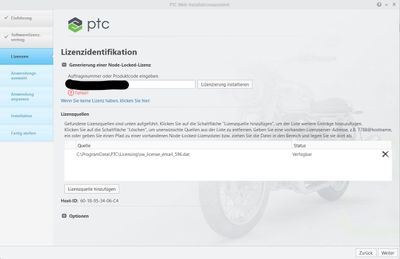

However, I received an automatic email from academicsupport@ptc.com with a license file. But I only get to the same pointScreenshot 2022-08-02 095340.jpgScreenshot 2022-08-02 094942.jpg
Here are the notepad screenshots of the license file from the email:
Screenshot 2022-08-02 095819.jpgScreenshot 2022-08-02 095852.jpgScreenshot 2022-08-02 100005.jpgScreenshot 2022-08-02 100035.jpgScreenshot 2022-08-02 095914.jpg

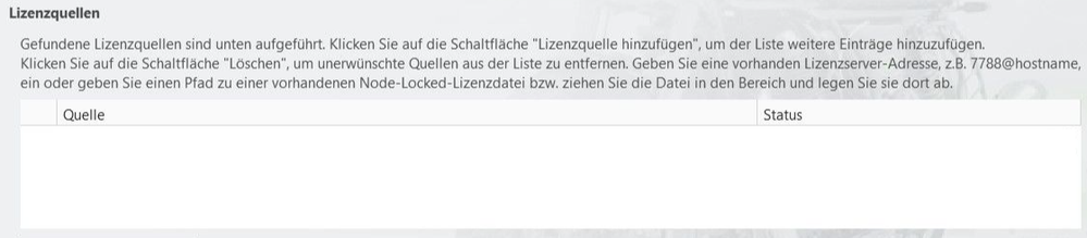

below you can find recommended installation procedure.
  • create C:\PTC directory
  • set access rights to C:\PTC directory to Full control for Everyone
  • create C:\PTC\Creo9 directory
  • save license file into C:\PTC directory ... for example you can use mylicense.dat name
  • download MED-100WIN-CD-460_9-0-0-0_Win64.zip and save it into C:\PTC directory
  • unzip MED-100WIN-CD-460_9-0-0-0_Win64.zip into C:\PTC\MED-100WIN-CD-460_9-0-0-0_Win64 directory
  • run setup.exe from C:\PTC\MED-100WIN-CD-460_9-0-0-0_Win64 directory
  • do not enter Product code
  • add path to license file into following area (for example you can use C:\PTC\mylicense.dat) ... remove invalid entries if necessary
  • continue with installation
  • enter C:\PTC\Creo9 installation directory instead of C:\Program Files\PTC

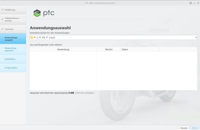

Martin Hanák
hmm unfortunately I come to the same result

maybe installation zip file is corrupted, please download it again from https://support.ptc.com/appserver/auth/it/esd/academicFree.jsp page.
How did you unzip zip file ? I use 7-zip application.
Martin Hanák
Thank you very much!
