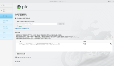

I had the exact same problem as you. I also tried CREO 9.0.0.0 and 8.0.4.0 and nothing happened when clicking setup.exe. And if you open Windows Events Viewer, there will be a baselibmt.dll fault. There was a popular solution in the forum before, but it didn't work for me, maybe you can refer to it——Solved: running setup.exe does nothing - Creo 8.0 - PTC Community
I solved the problem by doing this:
DO NOT download MED in Academic Free Page . And my friend sent me an ISO installer for CREO 9.0.1.0 by USB flash disk and the setup.exe in it works very well. The academic license is also valid by using the same code as CREO 9.0.0.0
Maybe, I think there are some bugs in the earlier version of setup.exe. Looking forward to the official analysis of the detailed reasons and give a reply.
