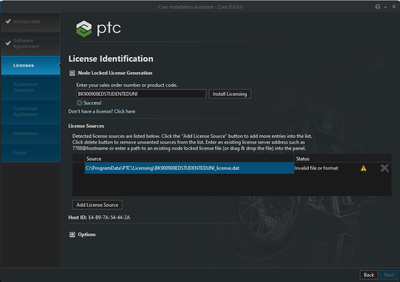

I am getting a similar error as shown below.  How should I proceed? The license name matches the instructional PDF exactly but it throws an "Invalid File or Format" error.
your license file is probably empty. You can verify this idea if you open the file in Notepad.
Sometimes Creo installer has problems to detect the right network card.
Please open Command prompt window, run ipconfig /all > ip.txt command and upload ip.txt file. I will check the contents of ip.txt file and let you know.
