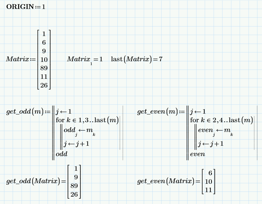

Buen día, comunidad. Tengo un problema al extraer los valores pares e impares de un vector en orden. ¿Existe alguna función para realizar esta operación?.

file saved in Mathcad prime 11.0 attached.

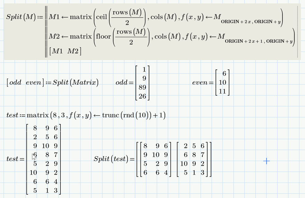

Just stumbled over this thread.
For whatever it may be worth, here is a different way to skin this cat:
The functions can deal with matrices with more than 1 column and works OK with any value you set for ORIGIN. But if ORIGIN is set to an even number like 0 or 2, the first returned matrix contains the rows with even row index (even though I called it "odd". 🙂
BTW, for questions about the usage of Mathcad or Prime you are better off and might get more attention if you post in the Mathcad forum.
