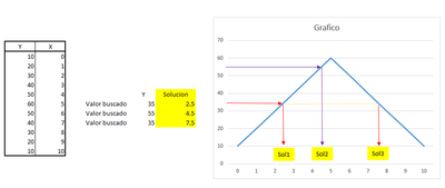

Good day community, I am new to the community and to the use of Mathcad prime, I have a problem in data interpolation since it asks me for the input data to be ordered, the peculiarity is that I want to enter by the ordinate (Y) and obtain the value of the abscissa (X). How could it be programmed to obtain these values. Thank you for your attention. Mathcad prime version V.8.0.

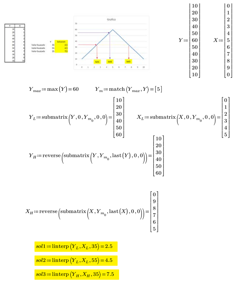

El uso de las funciones de clasificación integradas le ayudará; aquí tiene un ejemplo: https://support.ptc.com/help/mathcad/r10.0/en/index.html#page/PTC_Mathcad_Help/example_cubic_spline_interpolation.html#
