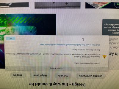

I deleted the license file in C:\ProgramData\PTC\Licensing, and copied it to directory Creo10_License.
Then, I installed Creo11, including the new license. The license installation was successful. The installation of CREO11 seemed to go well.
However, Creo11 did not start. I received the following message (see also attached content)
Then I had the idea to start up Creo10 again. To my surprise, it worked, without the message that the license would expire.
I also got an email with a .dat file. It contains the license data for CREO10. It tells that the new license will be available until 1 December 2025.
So, the renewal of the CREO10 license worked. But now I also have an installed version of CREO11, which does not work.
As long as CREO10 works, I am good. Should I uninstall CREO11? Or leave things as they are?
