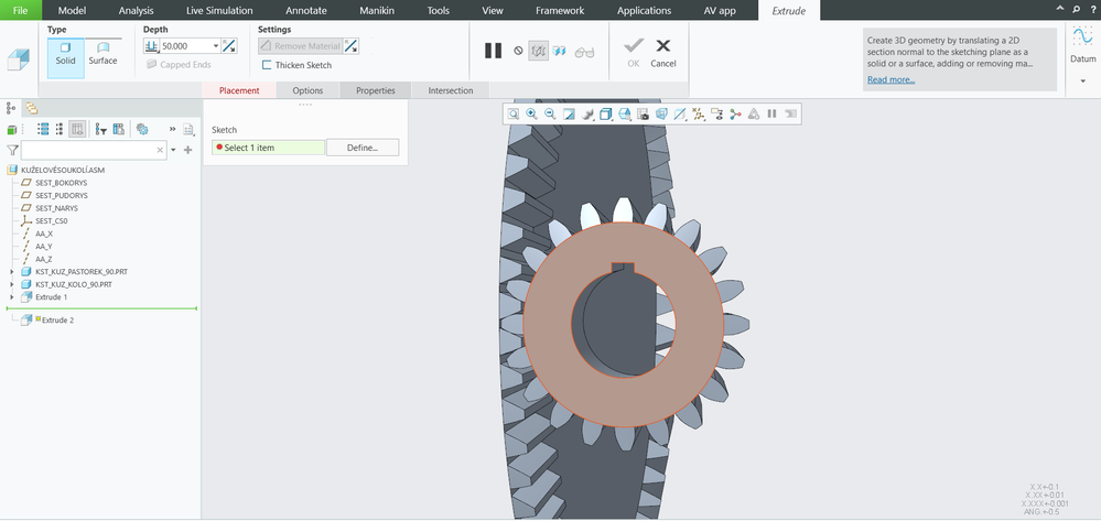

remove material is greyed out
IG_11092344
2-Explorer
I want to add marerial but it is automatically checked as remove material and i dont know why i can change it to normallCREO 2024-05-31 134817.png
1 REPLY 1
in Assembly mode adding material is not allowed. You have to activate specific part and add material into it.
